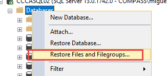

I open up EPICOR Admin, stop App Pool for AppServer (TEST)
I open up SSMS, copy name of DB, delete DB (TEST)
Restore File and Filegroups
Enter old DB name (TEST)
Click devices and search.
