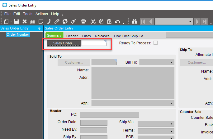

I’m at a loss for these two, however. I cannot seem to get an event I can hook into that I can check and do a stop if necessary. Right now, if the fields are blank, the user can click the button to search and select a new sales order or they can type a new one in and it lets them leave. I’d like it such that if they click that button or tab out of that field, I can do a data validation and if the data is missing, then stop the form from changing to the new order.
I tried creating a salesOrderBtn.Click event, but the search dialog comes up and then it runs my code. I would like it to run my code before the search dialog even pops up.

Ive typically made the native button so small it could not be clicked.
Then I just use a custom button and call something like saleOrderBtn.PerformClick
after running custom code from the custom button. Might not be the best way , but its worked in many places for me.

Basically all I do is call the click of the actual search button from another button with .performclick after running my custom code.
Create a button and add your code to validate.
Then after all your code put in btnKeyField.PerformClick
You will first need to reference the EpiKey on the formload for btnKeyField button.

Not sure if it’s easy to disable, but I believe the property EpiKeyField (or similar) determines whether or not it is validated by the system.
You possibly use the click event for txtKeyField to validate as soon as they click on the sales order text to try and change and if not validated dissallow editing.
