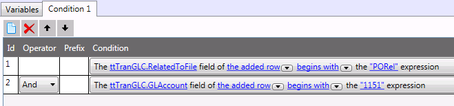

I’ve made a In-Tran DD to change the GLAcct used by the Expense Acct on PO Releases.
The condition is:
When that is TRUE, I use two Set Field blocks:
With the full expression: BpmFunc.Replace(ttTranGLCRow.GLAccount,"1151","1166")
and
With the full expression: BpmFunc.Replace(ttTranGLCRow.SegValue1, "1151", "1166")
This seems to work fine, but I’m a little worried with “tweaking” a table like TranGLC. And especially so because just changing the SegValue1 didn’t automatically update the GLAccount field.
