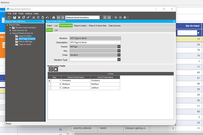

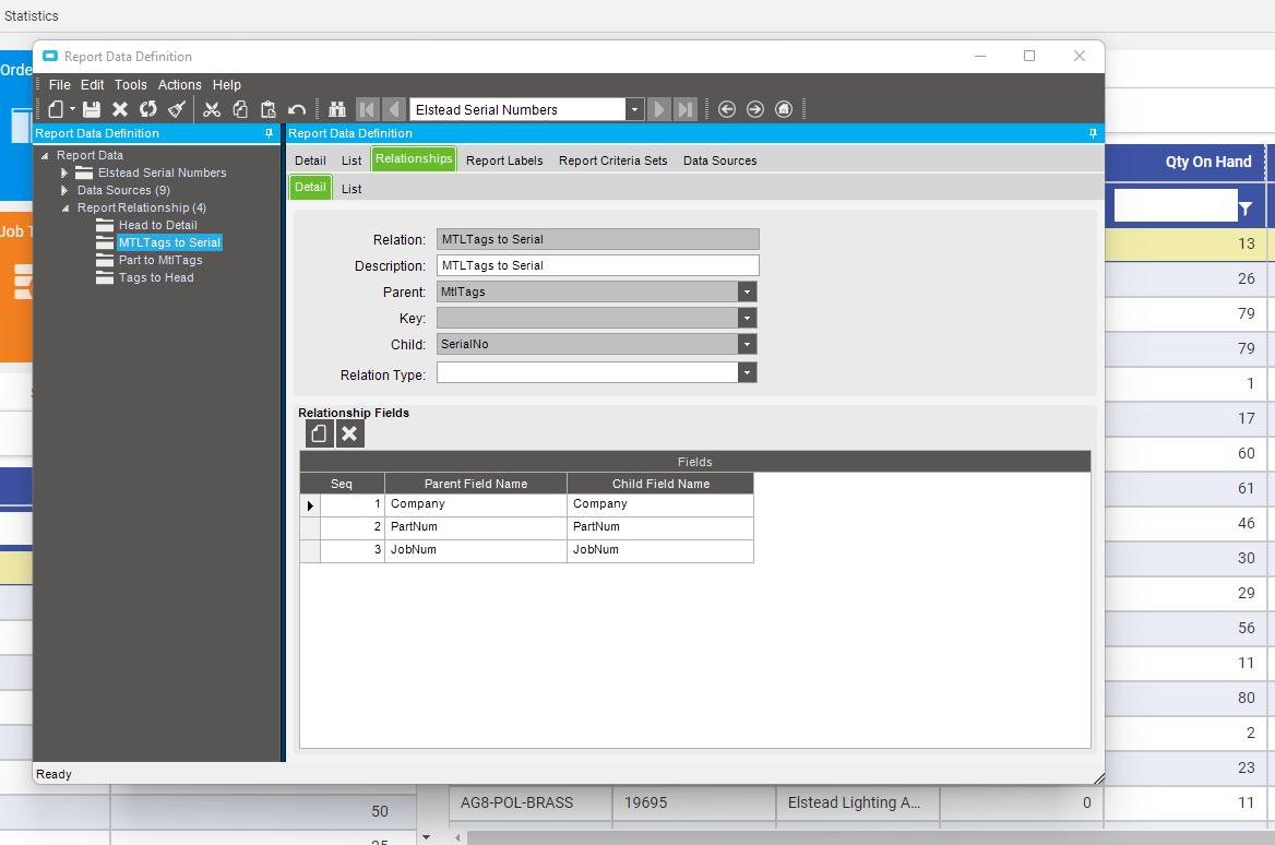

I created a data definition for the ability to print product labels through epicor mes however despite the part table and fields showing on the output file none of the product data appears please see attached.jlj.txt (4.4 KB)
Can you share a screen shot of the data definition joins you set up for the part table. Guessing that’s where the problem is.
Hello Zack i managed to get it working the only area im struggling now is to pull out the serial number used at the end of the job operation
Set the “Relation Type” to “Output” in the dropdown
I have got that sorted I have two barcdoes on the part master one for EAN8 and one for EAN13 so now when I put the EAN13 on my label it prints the label twice is there away to hide EAN8 ?
You can filter on the Bartender design’s database connection to prevent lines containing EAN8 data from showing.
