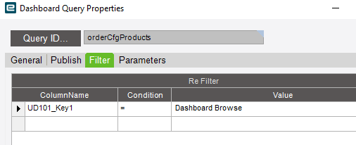

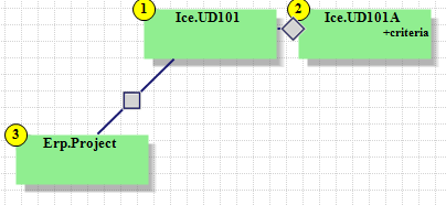

I have added a new dashboard sheet in OrderEntry. The BAQ gets a list of records from a UDtable which has Key1 = the Ordernum.
Question: How can I pass the current ordernum to the dashboard so that only records of that Order show in my dashboard? Kind of If I set a parameter, say “cmd” setting in the BAQ, within the Orderentry screen, how can I pass the ordernum to the parameter cmd of the BAQ?

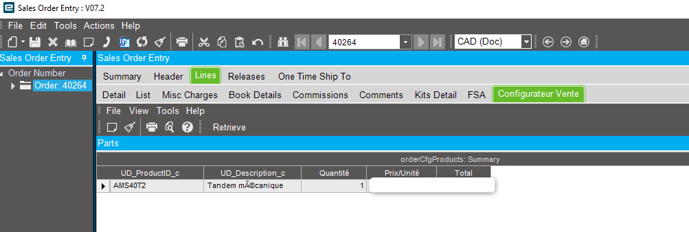

Another solution I was successful is instead of a Dashboard, use a grid where a would populate with the result of a call to the BAQ in code …

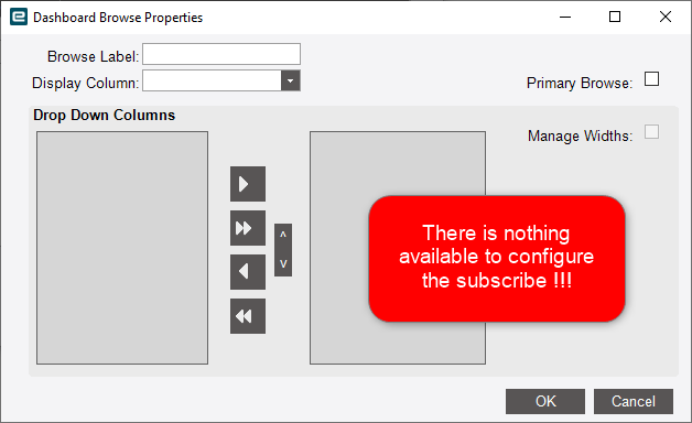

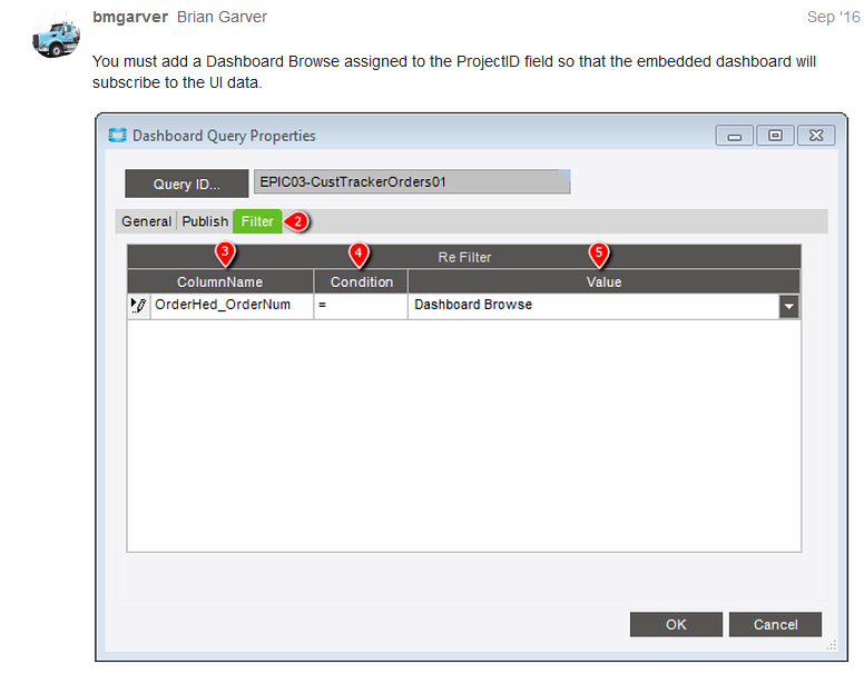

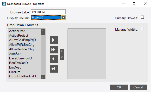

I cannot find the value DashBoard browse in my list of values to assign to my Key1 field…in my dashboard…as the note is indicating? What may I be missing? and where to set it ?.
This is new to me so I’m going to do a quick example.

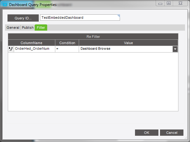

I created a BAQ that returns order num, company, and cust num. I created a dashboard and used this query as the BAQ. I create a filter on OrderHed.OrderNum. I type Dashboard Browse into the value of the filter and the dashboard browse properties dialog appears. I select OrderNum as the display column and also push OrderNum to the right side of the Drop Down Columns. I selected Primary Browse.
I save and deploy the dashboard. Notice how there is a new item on the dashboard:
I save the customization and all that and to test, I bring up an order number. Since I have the dashboard OrderNum mapped to the dataview OrderNum, it selects the order num from the BAQ based on the dataview in the customization.
I did just type it; it wasn’t an option to choose.
Try it with a brand new dashboard. The documentation was from a E9 topic, so I can’t imagine it’s version specific.

Dashboard Browse is not available for some tables.
e.g. UD tables, or others using Key1, Key2, Key3, etc…
( Schema Type = “System” in the data dictionary)?

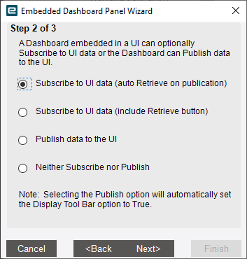

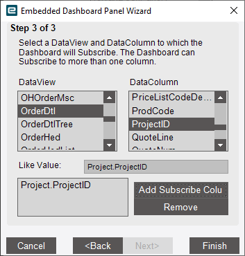

So if your BAQ/Dashboard uses a UD table and you cannot select Dashboard Browse is there any way to make an embedded dashboard that subscribes to the customization UI in these cases?
