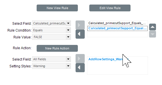

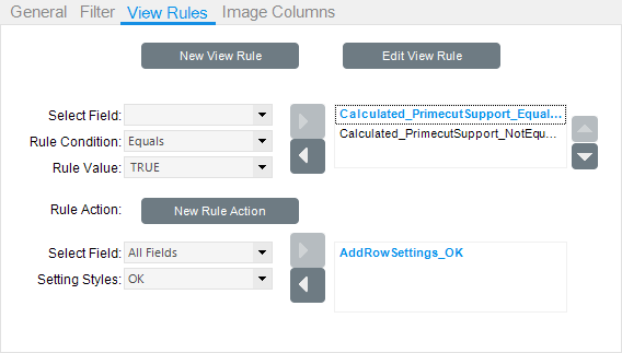

I have a calculated bit/boolean/checkbox field (“PrimecutSupport”) to indicate whether a customer has active support or not. In my classic dashboard I am using setting styles error and ok to highlight the customers with and without support (looks ugly in classic, looks nicer in Kinetic… when it works):

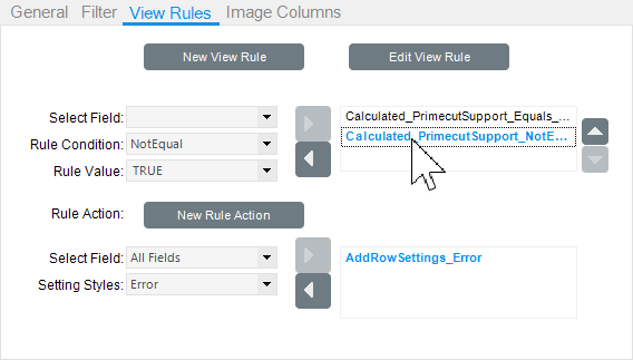

two view rules…

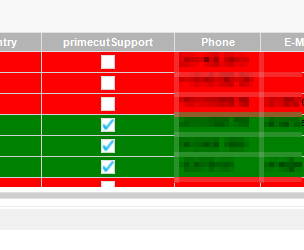

resulting in (Classic dashboard)…

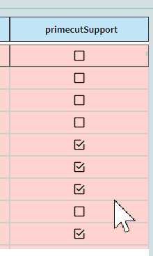

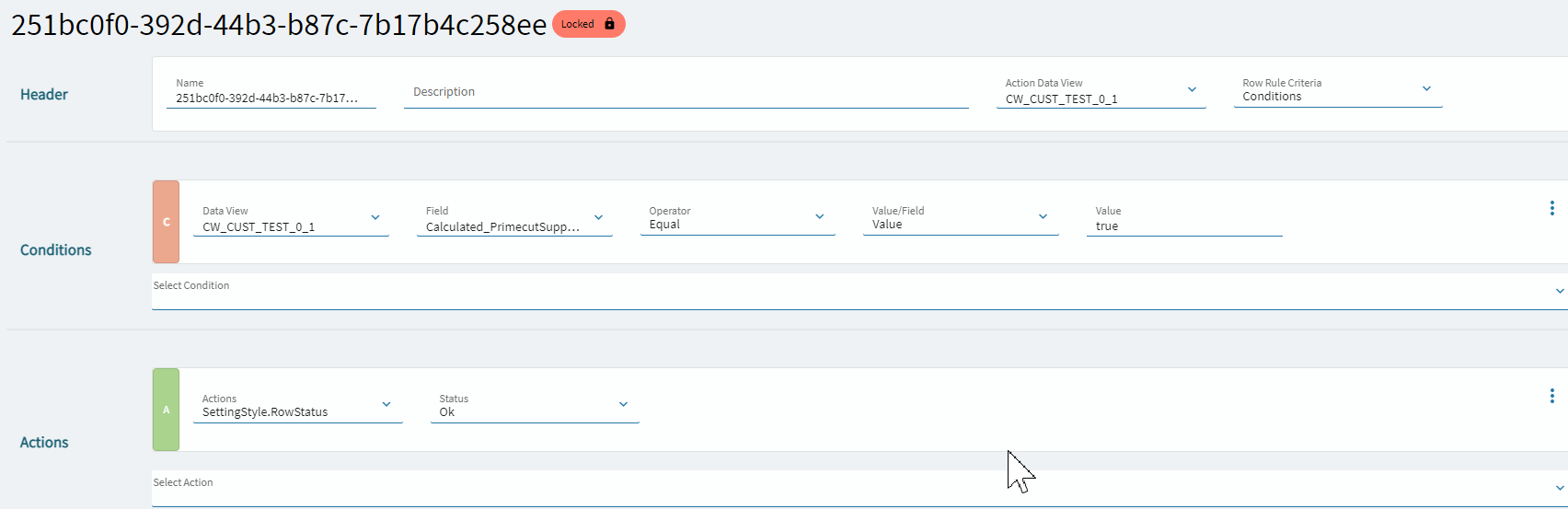

But when I deploy to Kinetic dashboard app, all rows are getting marked “error”:

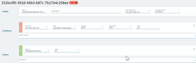

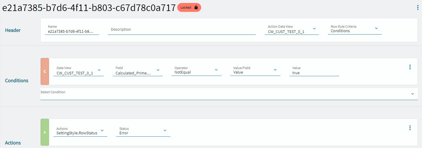

Looking in Application studio the Data Rules appear to have translated OK:
It appears the NotEqual true condition is always evaluating to true, so maybe I should be using some other constant than true, maybe treat it as 0 or 1 instead if true or false?

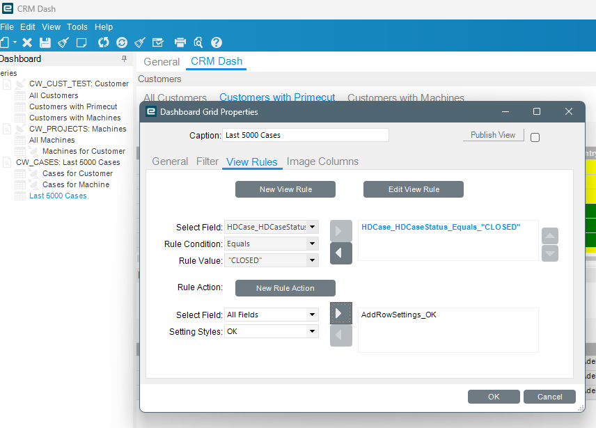

Thanks Mark, I took a look.
I can’t see where I would enter the custom code, the “wizard” I see is pretty basic; maybe I am in the wrong place? I’m not even sure how to specify the constant for my Rule Value, ie double quotes, single quotes, no quotes… regardless, the rule I’ve put in here isn’t working. I’ve tried Contains instead of Equals also.
