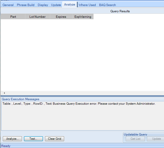

A few hours of cussing at my monitor and I’m still unable to come up with a calc field that works.
I finally came up with something that the editor doesn’t reject, but the query will no longer run with the calc field. When I test the query I get this: Table: , Level:, Type: , RowID: , Text: Business Query Execution error. Please contact your System Administrator.

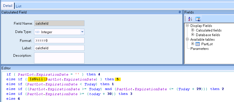

I did it like this based on your formula and it seems to work, or at least it doesn’t fail when I Test the BAQ. I don’t have dates, so you need to confirm date conditions are met.
if ( PartLot.ExpirationDate = '' ) then 4
else if ( IsNull(PartLot.ExpirationDate) ) then 5
else if (PartLot.ExpirationDate < Today) then 1
else if ((PartLot.ExpirationDate >= Today) and (PartLot.ExpirationDate <= (Today + 29))) then 2
else if (PartLot.ExpirationDate >= (today + 30)) then 3
else 6
Thank you again, Carlos. I have a feeling that since you aren’t using that field, and have no dates in that table, that troublesome expression didn’t rear it’s ugly head.
