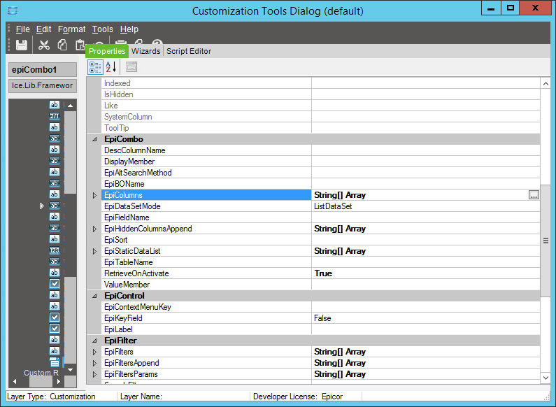

In the properties of the dropdown:
EpiCombo > EpiColumns
Add the columns you need there. Each column should take up one line.
