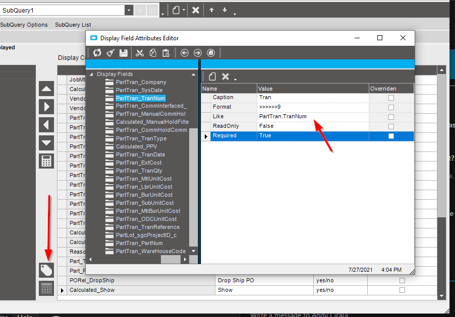

It uses the “like” property of the field. You can override that in the BAQ. But if you do that, it will break the open with context.
One way that I’ve gotten around that is to create a calculated field that is simply the field that you want to filter on. Then filter by that column, but show the other column so that the context menus still work.

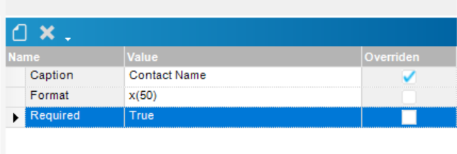

I thought that too, but here’s the BAQ:
