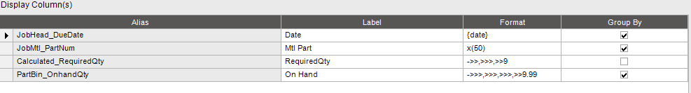

This is the BAQ. I was asked to use the original one as the data from it was perfect. So, I just simply added PartBin to get the OH Qty for Bin XYZ.

Here is a pic of the dispaly fields.

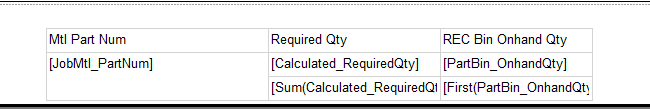

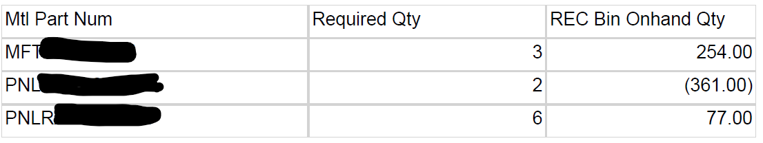

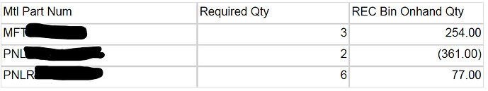

After i get the data I am looking for here, I need to show it in a dashboard like this:
Mtl Part Number, Required Qty (this is summed so that all Qty among the date range will ebb added in), OnHandQty (only need the first one of this as its the same for all parts in the list).
That would work, except for the adding stuff up. If you filter the dashboard with the tracker it filters this after the summing. You need a parameter to limit before the summing.
Are they wanting to use this like timephase? The parts on hand in that “REC” bin today may not match in a week or two when the job is due as the parts may get used by other orders.
From my understanding, since I am wanting the data being shown to not have any dates but have one line per part number, the required qty summed, but I need to use the date range for populating the data, a dashboard would not work, correct?
Basically, yes. They just want to have an easy way to look at mtl parts in a data range and see the OH qty along with the Req qty.
