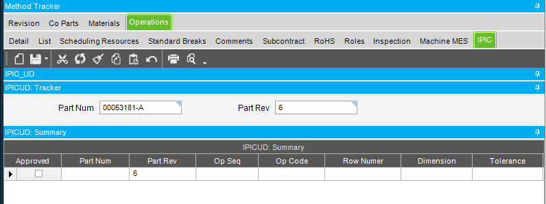

So I used the UD100 table to make a updateable BAQ, then made an updateable Dashboard with a tracker for Character 01 and 02. I deploy to a new sheet on method tracker,and everything is working great. Except i want the tracker to update with the part info when i load in a part in the method tracker. When i deploy to a sheet and subscribe my dashboard to the partnum and revnum from method tracker, My partnum and revnum are stored in Character01 and 02 fields. so they wont see each other to populate the field. i looked it up and cannot rename the Character01 field to anything else, so what else can i try? Any help would be great.

This worked Perfectly. Thank you very much.
The Rev number autofills when i add a new row, but the part number does not. I wrote a BPM to fill the Partnum, then the Rev number doesnt fill. Any idea what i need to do to get PartNum and Rev to autofill?
