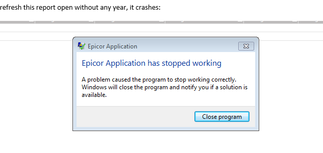

I know this is really a windows error but just wondering how others got around this. Accounting has this HUGE stock report (I hate it) and they run it wide open so it pulls THOUSANDS of records for the last 6 years. Of course E10 has to give my problems and they don’t understand why it worked on E9 and now issues with E10…SIGH
So first issue…
I can run this report fine in my training environment but in Production is bombs out with error message

It is a Dashboard…
Have you looked at all of your joins and made sure that they had “Company” in them? That can make a big difference. The other thing that you can look at is adding am index to the database. (Although usually I wouldn’t expect epicor to crash, just slow down…) If you run the report and just wait (don’t click anything) does it still crash? Or will it eventually finish?
