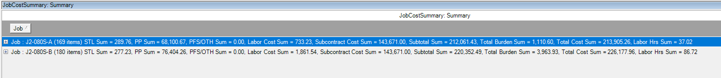

Thanks. I can deploy the dashboards but not menu maint. It is deployed as an assembly. Now I just need to figure out how to just show the summaries in a column view. I’m in customization now and looking into it. Any suggestions on how I can do this?
Ok. I have managed to get this dashboard to work but now I’m having difficulty making it match the production detail report. If I post the BAQ can someone help me find out why some jobs are showing all cost and others not?

The’ jobmtl.materialmtlcost’ in the Production detail report show as $242K, however when I break it out into the STL, PP, PFS (based on part class), and remaining Materials, my totals are $239K. When I removed the calculated fields for the STL, PP, PFS and left just the materials, I still come up $239K. But on another job, the BAQ is exactly what shows on the production detail report. I am missing something.
