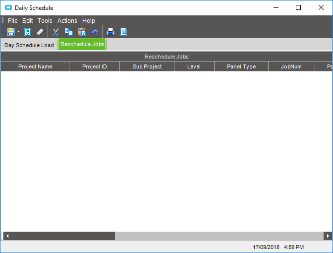

This is a User Interface question, I don’t know what happened, but my dashboard has gone from
to this
There is no properties in the dashboard that I can change to make the grid to dock the whole page. This is not the first time this happens. When this happens, I have to recreate the dashboard … Anyone with the solution, please share with me. Thanks.

  1. Tried all the rest in the layout
  2. The dashboard is not ok in developer mode.
  3. Clear client cache, redeployed many times, the grid simply not expanding to the width of the window.
I am on Version 10.2.200.4.
I can copy the dashboard, but in developer mode, the grid cannot be resized. I am hoping that maybe there is a properties somewhere that can dock the grid properly.
