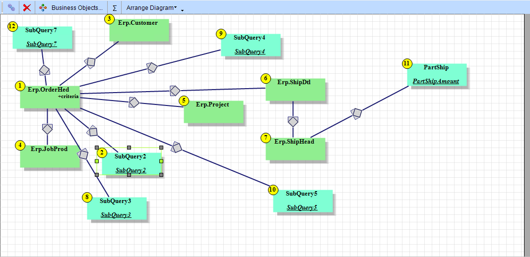

I have attached the offending BAQ along with a couple of screens if anyone can take a look.

Hi @ckrusen, your suggestion regarding the bad data got me thinking. I selected some random dates for my filters and started to narrow down where my problem was. At the moment I have found that if I set the date filters to show just the results for 18-9-2019 then the dashboard processes for around 20 seconds and then returns nothing. So I’m thinking there is something not quite right in my data for that day. I do not get any error message though. Is there a way to find out what has gone wrong, or where the problem is?
Adrian
Temporarily add that date as table criteria in your BAQ, and see if that runs.
Then duplicate the BAQ, and start removing sub-queries (one at a time) to see if the issue is with the sub-query. Note: You don’t have to delete the sub-q from the BAQ. Just remove it from the top level query.
If you find a sub-q that is causing problems with that date:
  1. Note the values of the records that the main query would pass to that sub-q
  2. Make that sub-q the Top Level query (and change the top level to an inner sub-q).
  3. Add criteria to the sub-q, to make it run for just the data that the original top level query would have had relationships.
  4. Then you can run the sub-q by itself.
That’s the direction I would go.

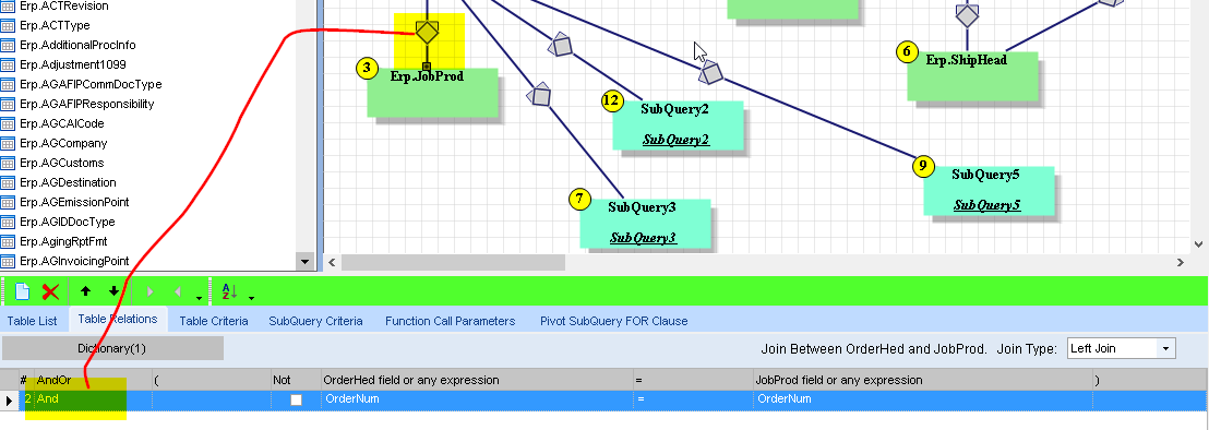

One more thing … I don’t know if it matters, but I see that table relationships on your top level query, that have only one relationship, have the AndOr field set.
Did you used to have table relationship #1 as OrderHed.Company = JobProd.Company but then deleted it?
If so, theAndOr should be blank
But you really should have the Company relationships in there too.
