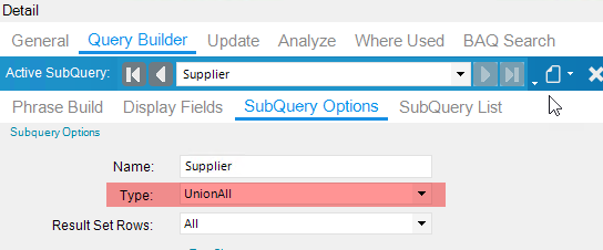

I have a simple example attached that you can look at that combines customers and suppliers with an added field for record type.
Union.baq (20.7 KB)
A union query is two tables on top of each other with the same number of fields and the same data types in each field. That is pretty much it. If you have complex queries, you will need to make sure the subquery list is ordered correctly so it knows how to process the union. UNION ALL will return all records from each union level and UNION will group the stack.
To start, create a top level query and design how you want. Then, create a subquery and make sure the column count and data types are the same and select your subquery union type.

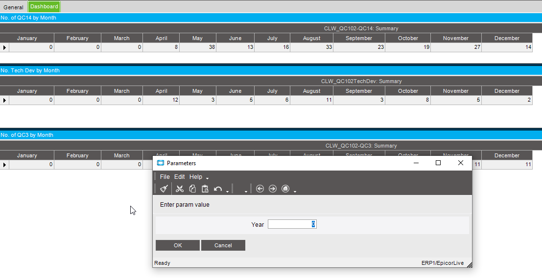

Here is how my dashboard looks so far
The Year parameter required for both queries is then used in Each month to perform calculations

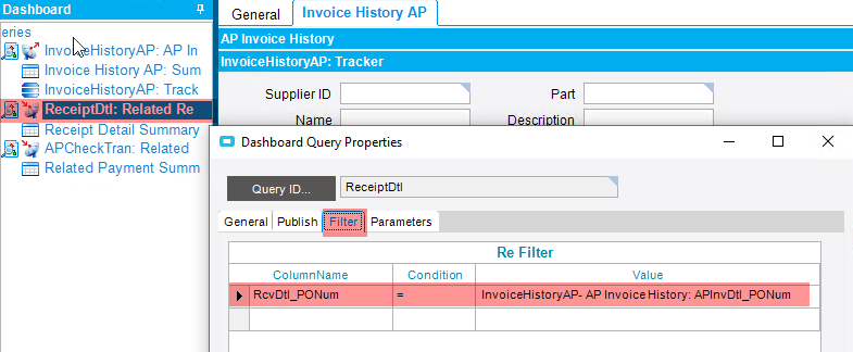

Hi Carla,

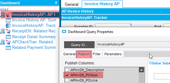

Right click on your first query, go to the publish tab and select your Year column. Inexact example below:

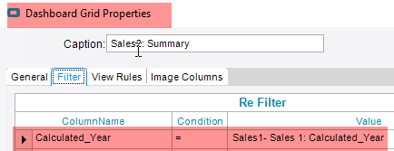

Click OK on your first query. Right-click on your second query, select the FILTER tab and map your second query year field to your published query field from the dropdown box. Another inexact example below:
Confirm that and test the dashboard.

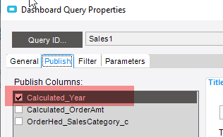

I was thinking create a Year calculated field on each query and put DATEPART(YEAR,< yourdatefield >) in it. This will give you the dynamic year. Group, filter as you will.

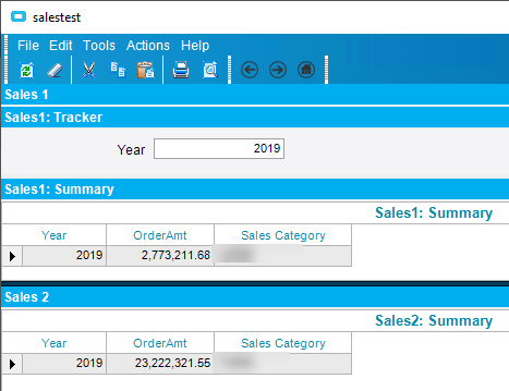

In the dashboard, it will have one parameter in the tracker view. It looks like you are using a BAQ parameter, which should still work as long as you have a year field in the first query to publish to the subscribing queries.
The 2nd/3rd queries can filter on this published year column from the same query.
Publish the column in the first query:
Subscribe to the published column:
