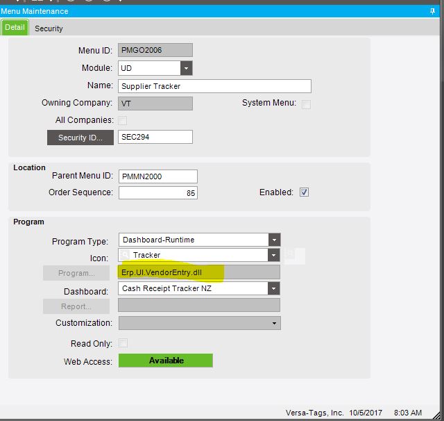

As you can see this is an Dashboard-Runtime tracker. But How did they get the VendeorEntry.dll into that? I’ve tried and it doesn’t work like that for me. LOL!
What I was asked to do, was on this Supplier tracker add in some Purchase Parts info from another BAQ. So I turned that into a dashboard and went about doing a simple Sheet wizard customization. Once I got all of that done, I saw the new tab and it worked. Logged out and back in and that tab was missing. As you can see, no customization allowed on this one. So i created another Supplier tracker with just the .dll and inputted the customization and still nothing. So, at a loss. That is what prompted me to look at everything critically and see what is going on.

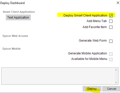

.In general, if you want to do customization to a dashboard - BEFORE making customization changes, deploy it as a Smart CLient Application - this turns it into an assembly (DLL).
Once that is done, if you create a menu item and pick the type to be DASHBOARD-ASSEMBLY, you should see you db in the dropdown. From here you can customize like a normal form. Once you’ve created a customization, you can go back to your menu item and set the default customization just like a form.

I see what you are saying. But in your opinion, using the tracker above, is it possible to add another customization to it?
Can you change the menu item program type from “Dashboard-Runtime” to “Dashboard Assembly”?
That should enable “Customization”?
But then it looses it connection with the Erp.UI.VendorEntry.dll. And that is something I can’t figure out. When you do the normal dashboard the program that is used is not the one currently being used. How did they get that set up like that ?

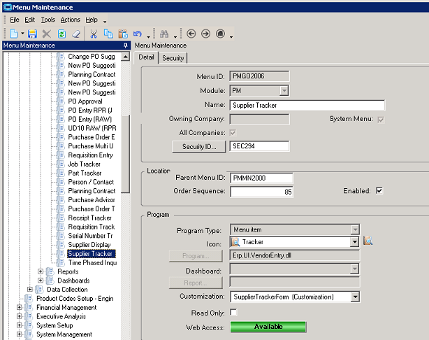

I assume you have opened this from the menu in dev mode… any clues in the form name?

I thought I’d check the old E9 menu and this isn’t a dashboard runtime,
My mistake, I see now that this is not a part of supplier management enhancement.
It’s just the regular supplier tracker.
E9… a regular menu item for the program - Epicor.Mfg.UI.SupplierTracker.dll
and… customization is enabled for this menu item.
(it does use a tracker icon).
So… I’m thinking this might be an upgrade issue with E10… maybe worth a call to support.
That’s very interesting. But I found a way around it that works very well. I copied the menu item, selected it as a menu and not a dashboard, program was erp.ui.vendorentry.dll, and the cash recipient tracker nz auto populated in the dashboard area. Then I just added my customization to it. It works identical to the original one but has the customization in it. so there is a way around it, but its not real user friendly. LOL!
This is an E10 upgrade issue - something in the menu does not get populated correctly during an upgrade process. Menu setup will display partially erroneously info - i.e. Dashboard Runtime and the default “Cash Receipt Tracker NZ”. However, the tracker and it’s customization are launched correctly, just as it would have in E9.

    regardless - see the screen shot for menu item - this is what the menu maintenance SHOULD look like.
