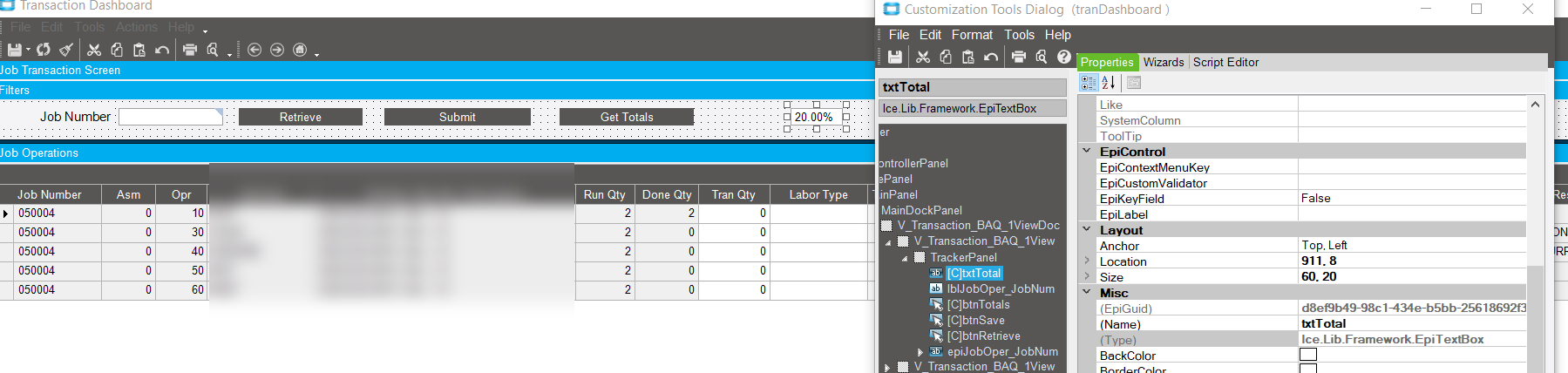

Make sure that txtTotal is EpiTextBox.
private void edvV_Transaction_BAQ_1View_EpiViewNotification(EpiDataView view, EpiNotifyArgs args)
if ((args.NotifyType == EpiTransaction.NotifyType.Initialize))
txtTotal.Value = 0.ToString("P2");
if ((args.Row > -1))
EpiUltraGrid grid = (EpiUltraGrid)csm.GetNativeControlReference("0bf0b691-0667-499c-a0d1-1d8341d2a69d");
decimal a = 0;
decimal b = 0;
foreach(UltraGridRow row in grid.Rows)
a += Convert.ToDecimal(row.Cells["Calculated_DoneQty"].Value);
b += Convert.ToDecimal(row.Cells["Calculated_RunQty"].Value);
txtTotal.Value = div_result(a,b).ToString("P2");
public decimal div_result(decimal a, decimal b)
if (a > 0 && b > 0)
return a/b;
return 0;
