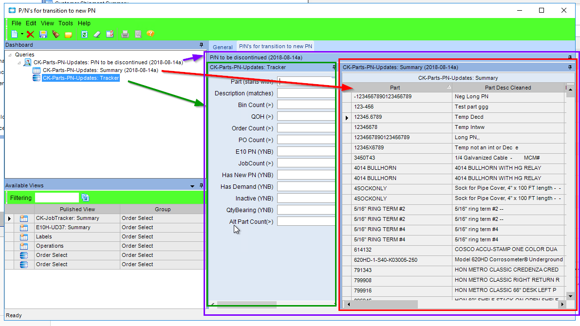

I have a dashboard with a header containing a few search fields, and a grid below. If I view it full screen, it looks right but if I use a smaller view, the grid overlaps the header and covers some of the controls. Is there any way to lock the height of the header so that doesn’t happen?

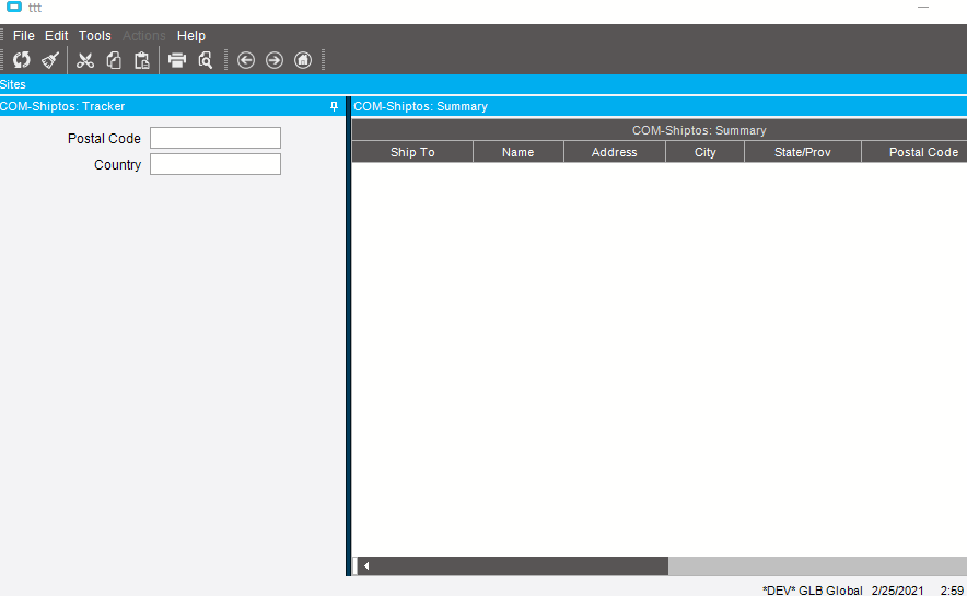

Next try dragging the panes until they “snap” to a location
to get:

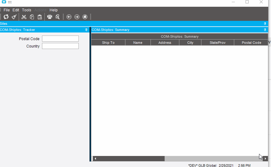

I drag the tracker pane until I see the snap outline:

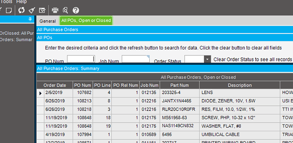

Does the “All POs” pane have a vertical scrollbar when it gets like that?
When I resize a window with panes setup like yours, it looks like it tries to maintain the ratio of the two panes heights. I think you’ll always need to grab that bar between them and drag it to a new spot after changing the window’s height.

Yes, it does have the scroll bar and I think you are correct that it trying to maintain the ratio. What bothers me is that I have seen dashboards with the same format that don’t have the problem. One thing I’ve noticed is that there is a thick black line between the grid and header on mine, and the dashboards that don’t have the scaling problem do not have that. I don’t know if that’s related or not.

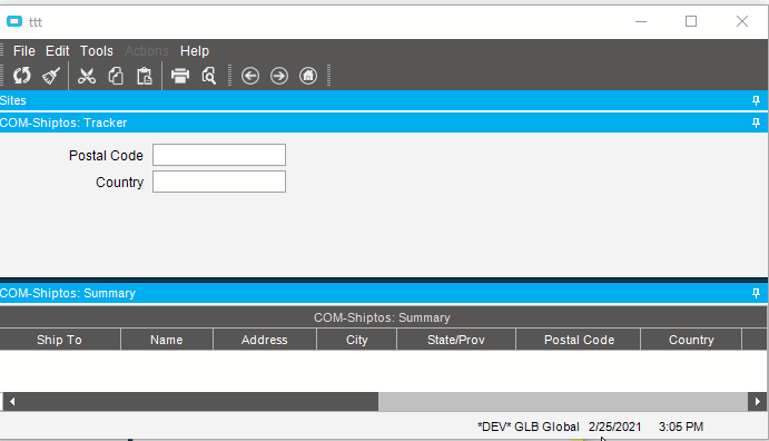

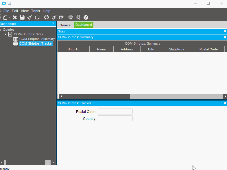

You have to drag the pane just 1px or 2px above the snap and there will be another snap, both snaps will be identical and its hard to confused them BUT one will be fixed, and other one wont.
Trust me there are 2 diff snaps, in the same location one is just 1px above

Notice in my screenshot on top it says “Sites” snap it to that, not the above the grid – but go up higher.
You’ll get it, snapping is mastered over time… took me a while to get good at the pixel
