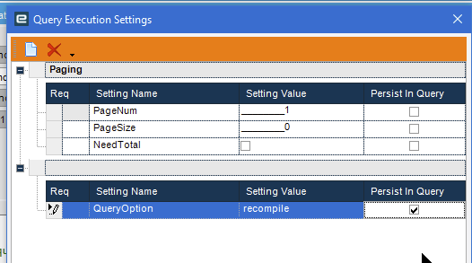

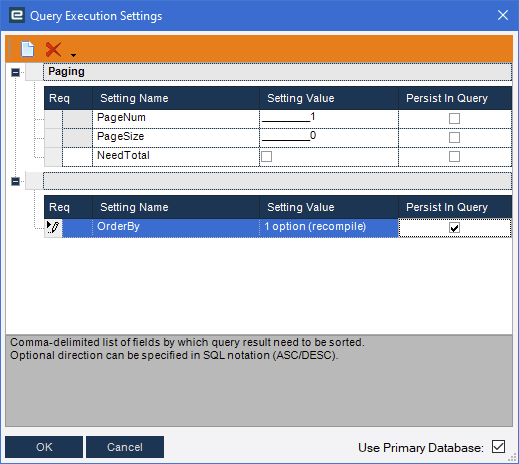

One thing you can try is to add option (recompile) to the query. If you’re still on 2021.2 you’ll have to hack it into it. Usually I would go into the execution settings, add and order by then in the field type 1 option (recompile)
which will add that onto the end of the phrase. That will make SQL rethink it’s plan every time so that it’s not doing something optimized for a totally different result set.
If you are on a newer version option
is one of the thing that you can set. It’s called Query option, and you can type in recompile.
In newer versions
In older versions without query option. (note, if you have an order set, this won’t work, and you’ll have to get more creative to tack it into the end of the query)
