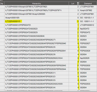

I did the Epicor Query first in MS SQL to get the concept down and then translated it into a BAQ within 30 minutes.
2018-05-08_0734

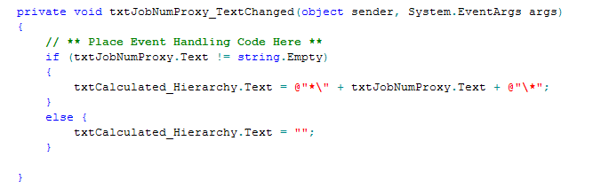

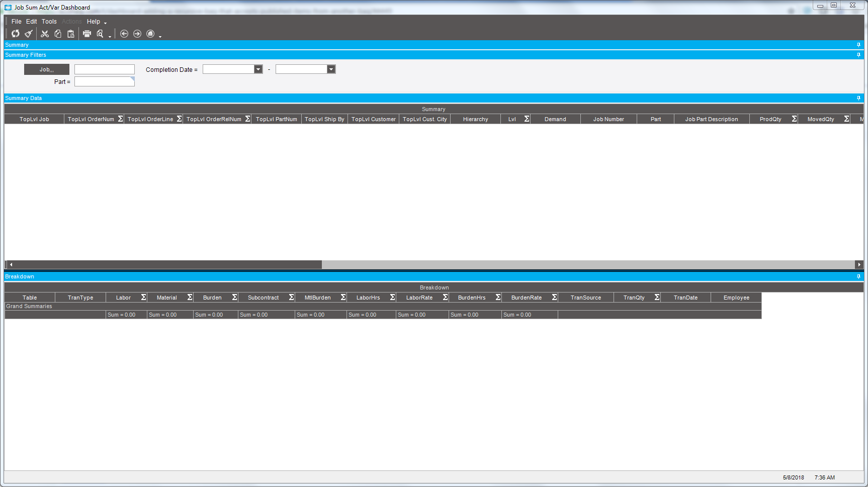

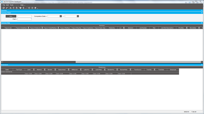

Then I made a dashboard with some Customization Layer to search the Hierarchy properly.
2018-05-08_0737
It executes within 2-4 seconds and traverses through all JobProd Levels. But I hope that link above and some of the info shared here, assures you atleast that it is possible =)
