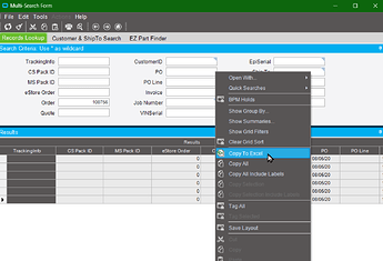

Normally, a simple right click to invoke the Epicor context menu in a DataGrid will provide you with a Copy To Excel option which will create an Excel file using the data in the grid that you can then save to a different format (CSV).

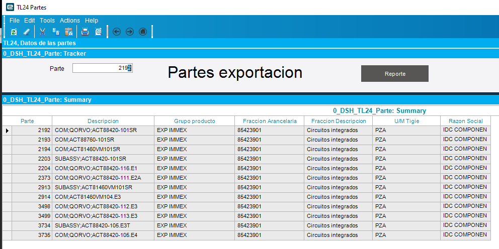

The dashboard look

You need to initiate a epiDataView with your dashboard dataview which carrys the information. There is helpers built into the customisation screen.
Youre receiving the error as youve not done this yet.
Based on that, my understanding is that you wish to automate the process of copying the DawaView to Excel with additional headings prepended to the DataView.
Simple break down you will need a modified version of that chunk of code in thread @aarong posted and to prepend the data to write with your customized header data. Something like (based on post above) this:
