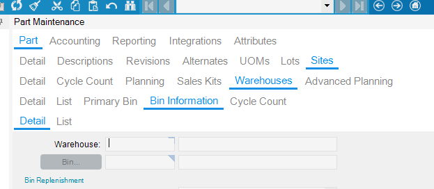

I have made some bins inactive and even though it is not the primary bin for my part, it was, once upon a time. Even though I have changed the primary bin for this part, I cannot put this part # into a cycle count batch. I get an error message stating that the part has an inactive bin. I found a connection to the inactive bin in the part maintenance screen → General tab → Sites tab → Warehouses tab → Bin Information tab. I have deleted that as well. Still getting the same error message.

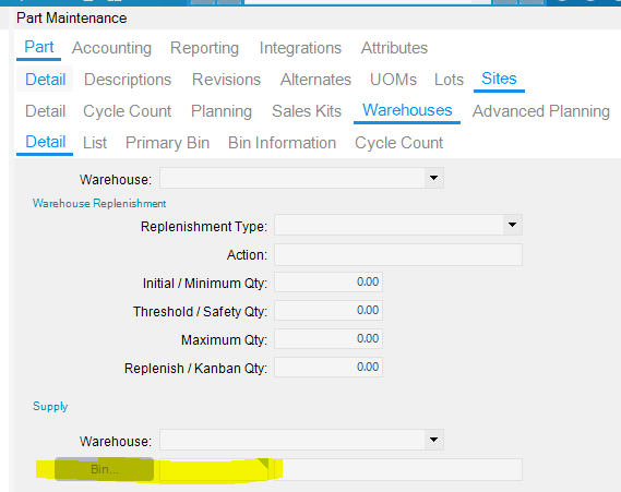

Do you use Kanban? Meaning this part of Part Entry:
I gather you are good with BAQs. That is the PartBinInfo table.
Or perhaps here (PartWhse.KBBinNum):
Just to recap, the places I know to look for an inactive bin are:
  • PartBin.BinNum
  • PlantWhse.PrimBin
  • SerialNo.BinNum
  • PartBinInfo.BinNum
  • PartWhse.KBBinNum
But I only expect the bold ones to matter for cycle counting.
So you’d do a BAQ on WhseBin, filtering to inactive only, and join to one of these tables at a time.
