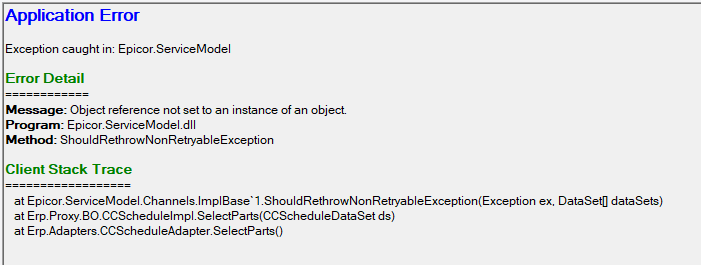

I am getting the below error when trying to “Perform Part Selection” on 3 out of 5 warehouses.
I believe that is a known error. See KB0050786 on EpicCare.
You will have to request fix FX_Del_PartPlant.df to remove some orphan plant records for the parts in question. Not sure how they get there but you if you want to verify you can BAQ the part plant table to see them. On our case, the partplant record was in there but it has extra spaces on the end of the part so you might need to use LIKE to see them.
