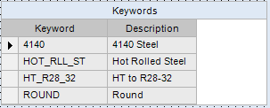

But, as you can see, the grid columns are not cooperating.
Following your examples, I was able to use the Event Wizard and add the InitializeLayout event (specifically for the “Keyword” grid as my test).
Within the added private void section, I then added:
args.Layout.Bands[0].Columns[“UDCodes_CodeDesc”].Width = 50;
< no resulting change >
I then tried:
Grid_Keywords.DisplayLayout.PerformAutoResizeColumns(false, Infragistics.Win.UltraWinGrid.PerformAutoSizeType.VisibleRows);
I then noticed that you originally had a min and max width called out… so I wondered if I needed all (3). So I tried adding all three constraints:
args.Layout.Bands[0].Columns[“UDCodes_CodeDesc”].MinWidth = 50;
args.Layout.Bands[0].Columns[“UDCodes_CodeDesc”].MaxWidth = 50;
Again, no resulting change to the grid column widths. I still have the below.
I even tried all (4) of your width arguments together and it didn’t result in any change. I’m not getting any errors… just no change in column width.
Probably not the best example, as these all at least fit in the grid. But I have other keywords with descriptions that get cut off… so I’m trying to extend those.

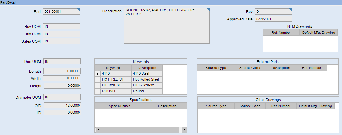

Right now, the Dashboard loads, and the User can search the Part Number for which they want more information. Upon selecting the desired Part Number, the dashboard updates along with the multiple ultragrids. The problem is there is a TON of different UltraGrid Control Events. I’m wondering if I’m calling out the wrong “event” type?
Perhaps AfterCellUpdate… or AfterSelectChange… any thoughts?

I am not really sure what I’m looking at in these screenshots, but perhaps it would help to explain the end goal a little. I see some nice clean looking grids, but I’m sure you’re looking for something specific :slight_smile:
My first image above is of the Dashboard w/ (5) separate Grids all bound to different BAQDVs.

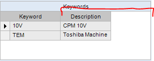

The second image is of the “Keyword” grid… which shows a lot of open space.
So, in this case, I would like the “Description” column to extend over to the end of the grid container. Whether that’s by a static width length, or an auto-extend, either works for me.
