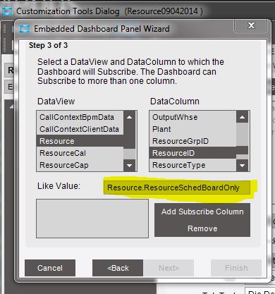

I am trying to customize the Resource Group by adding a Dashboard via Sheet Wizard. And I kept getting this error of “Warning- Embedded Dashboard invoked as a Subscriber, but there is no Filter defined for the Published columns. Please notify system administrator.” So I was looking over everything and I wanted the data to be called by the resource ID. But when I selected the REsourceID I noticed Like Value was completely different than everything else in the list. Here is the screen shot. Would this cause issue?
resource

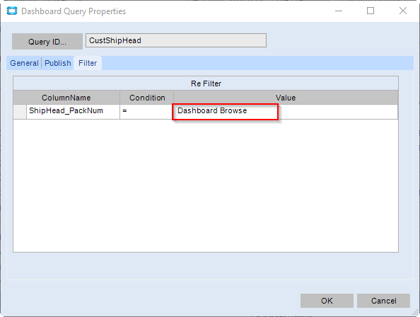

  1. The ResourceID field must be a field in the BAQ used for the Dashboard.
  2. Right-Click the Query and select Properties.
  3. Create a Filter for ResourceID = Dashboard Browse.

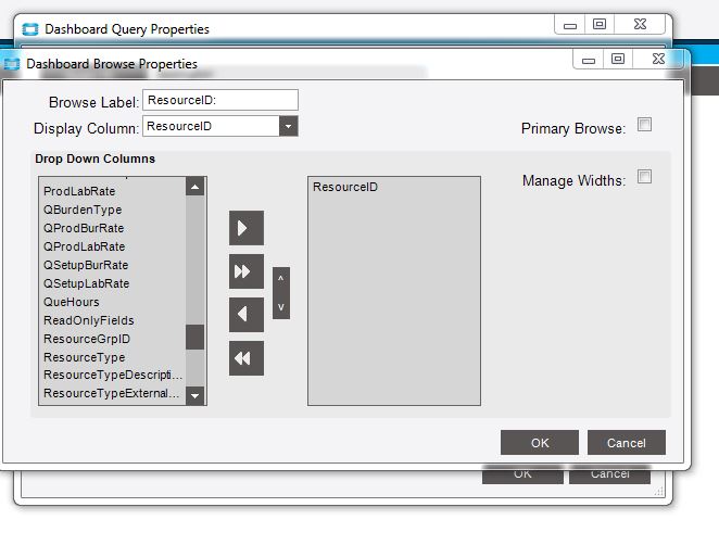

Like this correct?
Correct, and check the Primary Browse box. Then re-Deploy the Dashboard before adding to the customization.
