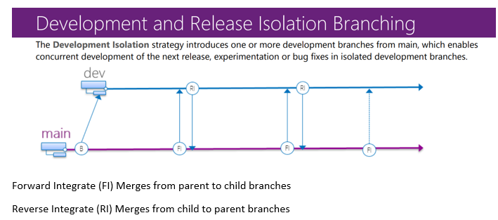

Advanced: What you may want to work toward in the long term is a source control repository outside of Epicor ERP that will help to flag and manage the current version of the customization so that no work is lost. Companies with high technical maturity with this process may suggest using branching within source control, which can also assist in merging changes made by different developers. This involves the making changes in their branch, then ā€œForward Integrateā€ merging the shared branch into their branch to resolve possible conflicts, then ā€œReverse Integrateā€ merging the local branch into the shared branch.
Here’s a quick note on development cycle branching in a source control system:
Diagram is from a Microsoft paper on TFS branching strategies.
I should note that in my experience working with various companies, I don’t usually get to the branching and merging level of technical maturity, opting to simply use the check-in, check-out functionality of a single set of objects in a source control repository in working with small teams.
