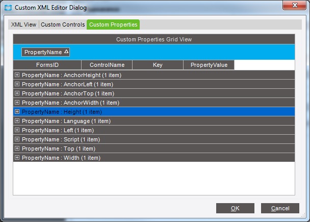

Custom XML Editor dialog
2 - Within the customization under Tools->Custom XML Editor on the Custom Properties Tab, if you Right-Click on the grid and Select “Show Group By”. Move the Column PropertyName into the “Group By” area. It will pivot the data to show PropertyNames. The one you are interested in are “AnchorHeight”, “AnchorLeft”, “AnchorTop”, and “AnchorWidth”. If any of these are showing then those controls are holding on the original location. Clear any records under these 4 PropertyNames. Do not clear the “Anchor” properties. Honestly, I am not sure if do so is a problem, I just don’t.
These 2 options are always my issues with freak-out screens.
Looked into both of those Dan, but 1 of the users who reported the error doesn’t have any personalizations on the customization and there weren’t any records under the anchor property. Thanks for suggestion.
