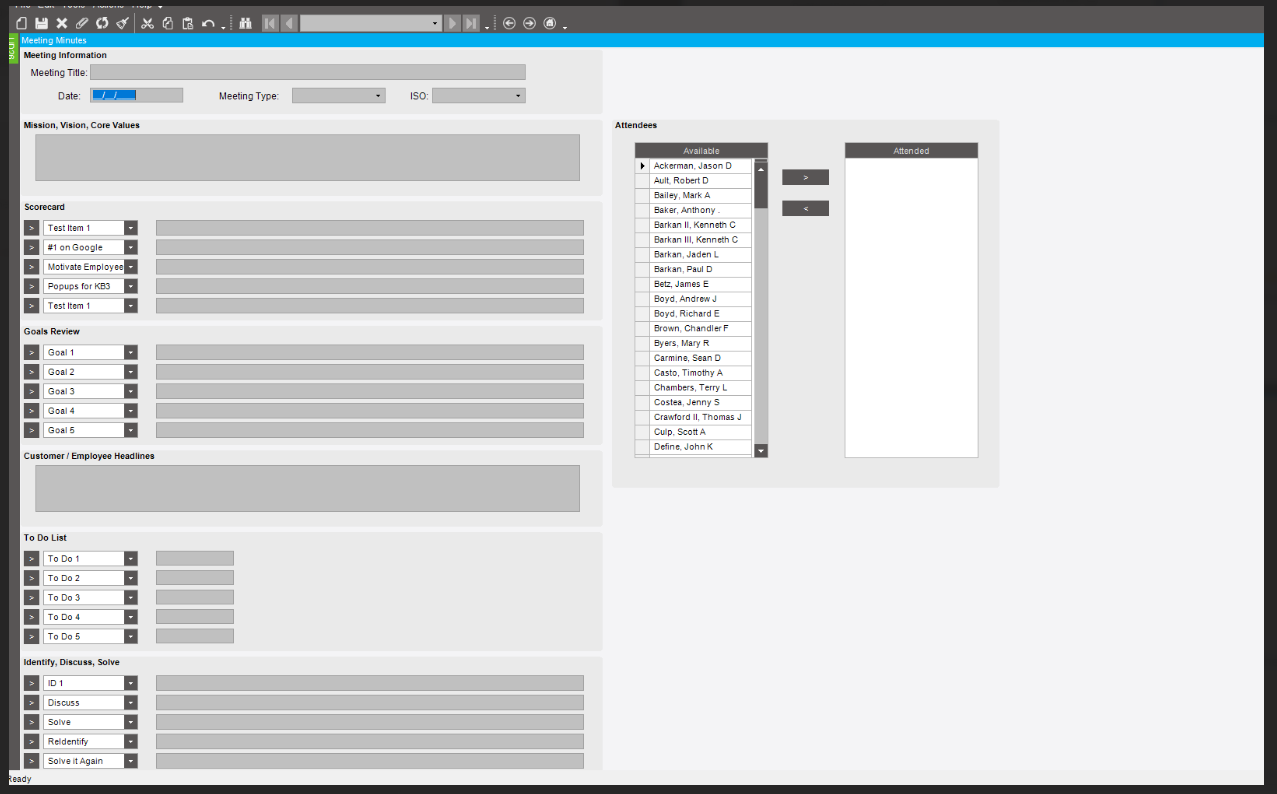

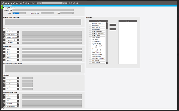

I created a fairly in depth customization for the UD26 Entry form:

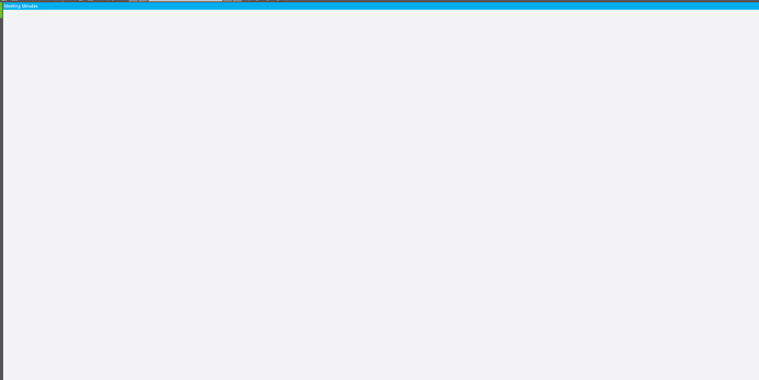

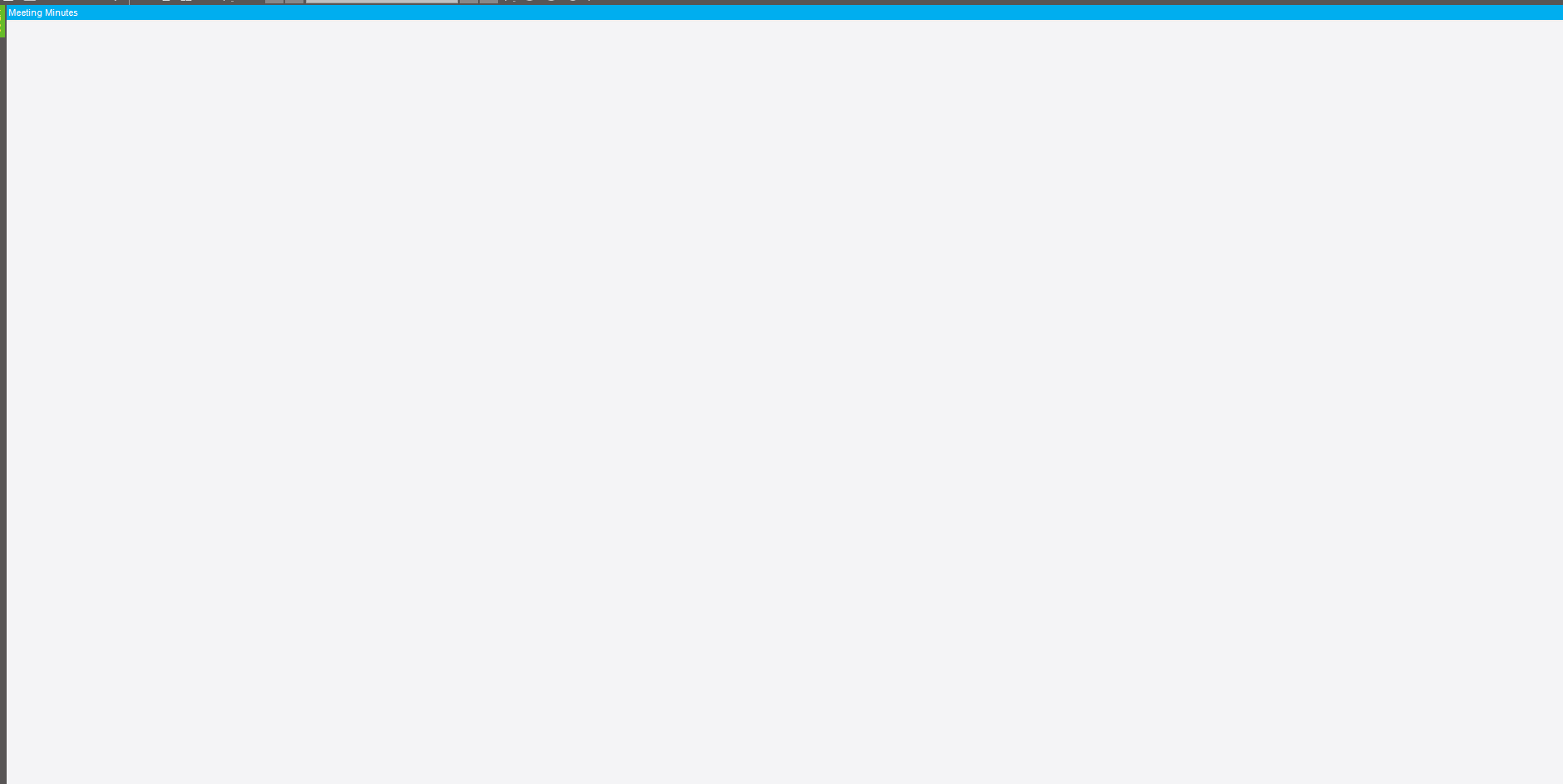

The problem is, it only loads 1 out of 5 times. Most of the time it loads as this:
I can clear the client cache and manually delete the client cache folder on the PC, and it still doesn’t necessarily load correctly. Usually if I close and reopen Epicor multiple times, it will eventually load correctly.
When it loads as a blank form, if I check the code, it’s all there. If I check the XML controls, they are all there. If I look in the tree view, none of the new controls are there. And obviously, they are not showing on the form. But the code compiles fine, even though it points to controls which don’t exist…

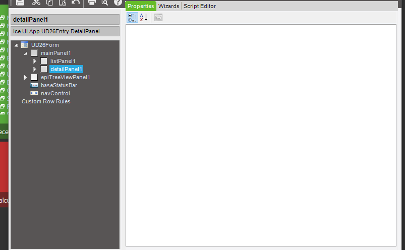

Seems a big part of this might come down to the fact that the details for my detailPanel where I have set all my controls seems to have lost its properties:
I have two customizations based on UD26Entry where this behavior is happening and both of them also have this symptom. Also, when using the toolbox, any new controls dropped onto it (detailPanel) disappear as well. If I create a new customization based on the Base of UD26Entry, same behavior results for detailPanel - no properties and anything dropped on it doesn’t appear.

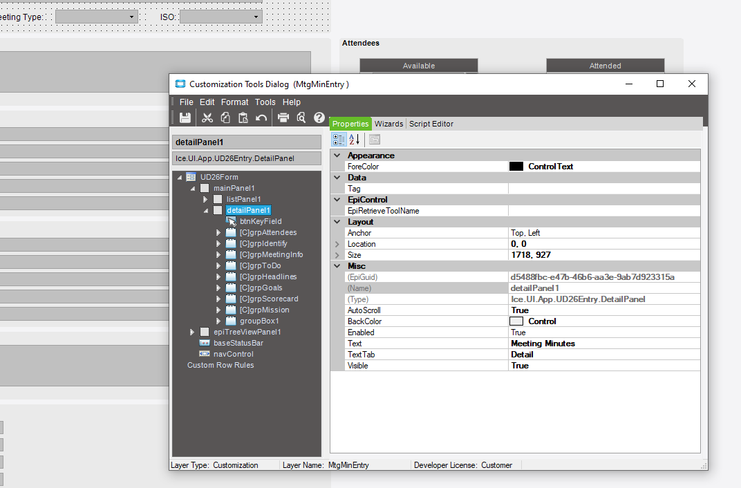

It started working again. And my properties are back:
I created another menu item based on UD26Entry. I then attempted to assign the customization to the new one. One of the two broken ones was listed, the other was not. I chose the one and it worked now. I then went to the customization maintenance, loaded the other (it was listed here, also was available if attempting to open with developer mode on, not listed in menu maintenance). I exported it, reimported it and then it appeared on the menu as an option for customization. I set the original two menu items back to their original customizations, and now it all works.
