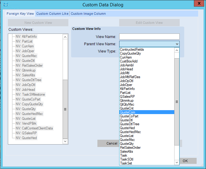

Use a foreign key view (FKV) to bring over the project

Parent view would be QuoteDtl, then you need to bring in the Project View.
Thanks for that Jose, I can now use the Project table but am unable to get any Project Phase detail from it. I tried to create another FKV with my fkvProject as the parent but the customisation threw an exception at that. How can I get to the PhaseID and PhaseDescription?
