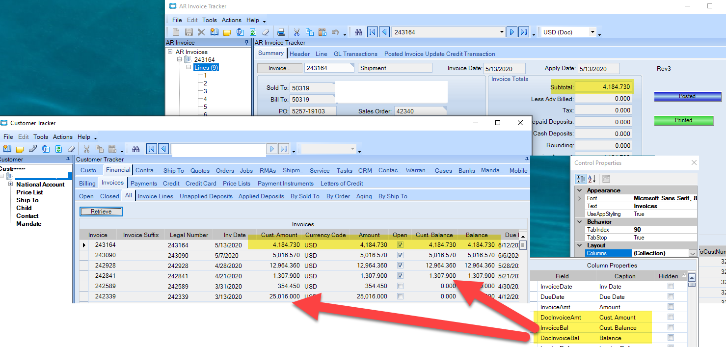

Finance looks at customer tracker > Invoices > All to get a sense of how much business a particular customer does and how much credit they need if we offer terms. Unfortunately, the invoices subtotal doesn’t show up(see screenshot below). I looked at Field Help and the subtotal appears to be a calculated field, also looked at InvcHead and InvcDtl and I can’t seem to figure out where the $897.75 figure is coming from. The InvcDtl.DocExtPrice is $855. Finance wants that $897.75 figure to show up on customer tracker, but I don’t know how to do that(ideally unhide some field just don’t know what it is) or even create them a new BAQ but I can’t find that data in the DB. Can someone help me out?

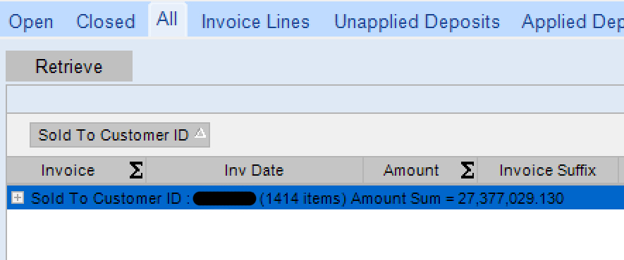

Right Click on one of the columns, and turn on Summaries. Then click on the Σ symbol on Amount, and select =SUM.
Then Right Click on one of the columns, and turn on Group By. Drag the “Sold to Customer ID” column up to the Group by area that was created.
That’ll group everything by the customer id, and sum the amount column.
You can click the + to expand the details.

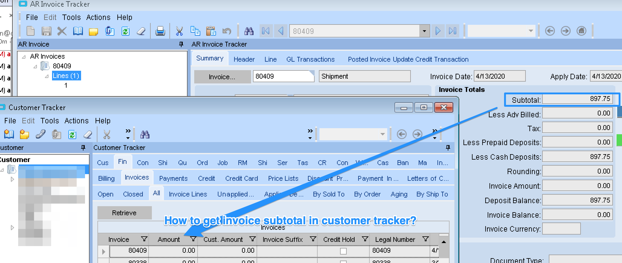

@TommyD the problem I’m having is in the screenshot invoice 80409 has a subtotal of $897.75, but in customer tracker invoice 80409 shows $0 values for all fields. None of the fields displayed show a dollar value > $0.
That’s weird. Does the Cust Amount column contain the data?
@tommyD no, see screenshot it’s $0. I wrote a BAQ looking at InvcHed and InvcDtl and can’t figure out where the $895.75 comes from in the database.

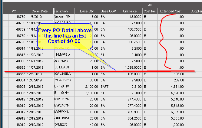

I just ran into a similar thing on the Vendor side. The ExtCost for every PO - prior to a certain date - is zero.
It shows on the PO Tracker too…
At first it looked like it aligned with a recent upgrade (10.1.400 -> 10.2.300) on 12/15/2019. But there are PO’s creted before that date that do properly calc the Ext Cost.

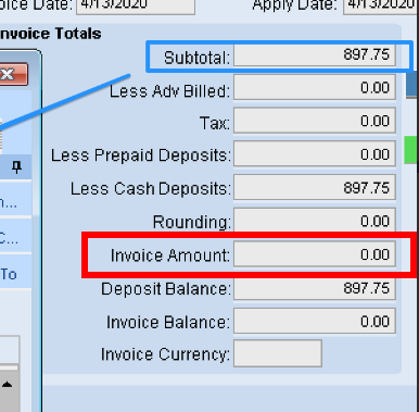

It looks like your issue is with the fact that a Cash deposit was applied to the invoice, thus reducing the Total.
@ckrusen thanks for your reply. Sorry I’m not very familiar with finances so I’m not following your reply. Are you suggesting this is a bug I should take to support(Why is the Invoice Amount $0?) or is this expected behavior?
I did figure out how to show the extPrice for finance(minus taxes, and misc charges I understand), but I didn’t figure out what fields will give me the illusive $897.75 value I see in the subtotal of AR Invoice Tracker…
This could be different depending on which version you are, but the basic formula is:
SubTotal = Invoice Amount + Prepaid Deposits + Cash Deposits + Lines Advance Billing - Taxes - Rounding
So in your example it is basically SubTotal = Cash Deposits
At least on the most recent version you can find this amount in InvcHead.DocDepositCredit, doesn’t look like Prepaid Deposits are kept on InvcHead but rather calculated from other tables.

We upgraded from 10.1.600, and it broke the PO totals. In 10.2.300 onwards there is a built in fix for it:
