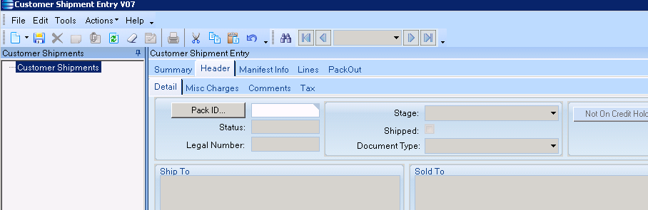

On version 10.2.2. Here are the steps I go through.
  1. Create new Customer Shipment Entry
  2. Enter Order Number
  3. Create new line
  4. Enter Order Number, line and release number
  5. Enter Qty , warehouse, bin and Lot number.
As soon as I press save, the Shipment status change from OPEN to INVOICED, all the things will be greyed out and I cannot modify any data anymore, because the Shipment is Closed straight away, I cannot open it again.

On the Pack header before you save is the shipped checkbox checked? I think you have covered everything else I can think of
I have tested both situation,
  1. Saving the Shipment Entry with Shipped Untick
  2. Saving the Shipment Entry with Shipped Ticked
Both result the same, Shipped will be ticked automatically when saved and the status will change to INVOICED.
