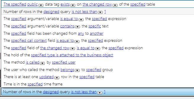

Create a variable.
Use the Set Argument/Variable to evaluate the condition to the variable.
Then use the Condition widget to check the variable
If yes, raise exception.

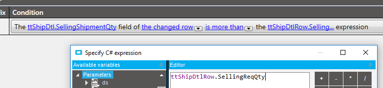

I used:
anyone see any errors in this approach?
Along the lines of what ken is mentioning here - you should be able to do this in SaaS by using the query condition
I would still add the checks for the ShipQty incase there have been partial shipments.
Your Expression will be something like: if you don’t do partials your code looks good to me.
(ttShipDtlRow.SellingReqQty -(ttShipDtlRow.OurJobShipQty + ttShipDtlRow.OurInventoryShipQty)
