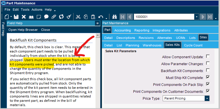

Hi,
May be select the backflush kit components in the part master for main part.
Below screen shot for your reference.
I have tested as below, its working fine.
Thanks for your concise reply. For our shipments we need to be able to select the relevant Lot number and Bin location. I believe we wont be able to do this if backflush is checked.
Even if we could simply select the Customer Managed Warehouse when we create the Packing Slip it would be pretty simple but the only only we get is to select our own warehouse.
