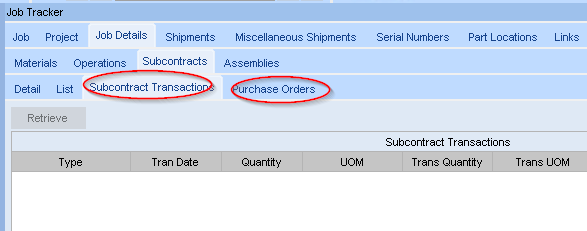

  7. Shipping: use Subcontractor Shipment Entry to Ship Material B to supplier XYZ… on that program, you will reference the PO and the JOB involved above. This ties everything together, and creates a paper trail. (THIS STEP IS OFTEN SKIPPED).
    NOTE: At this point, in job tracker, you can look at the operation and see when the material was shipped to the supplier.
