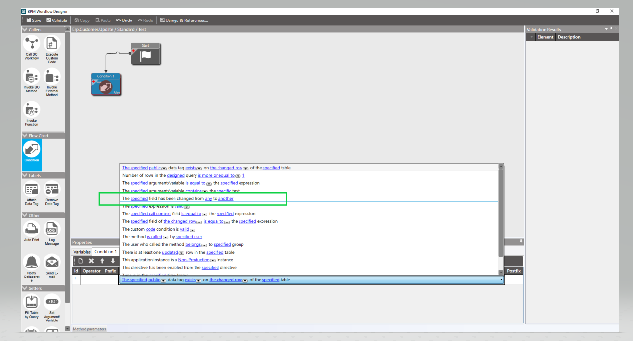

Yeah, I would go with a Standard DD on the customer table. Could you share a screenshot of the DD you’re working on? Maybe there’s something missing, as I do have this option under the condition widget.
Interesting… I’ve been working on this using the Kinetic UI… as soon as I switched over to the classic, I could see that condition.
I’ll give that a try in Classic and see if I can make it work. Thanks for that!
Evidently the Kinetic UI of Method and Data Directive are not completely finished according to this post - Kinetic 2023.2.4 Data Directive BPMs Read Only (Locked) - Kinetic ERP - Epicor User Help Forum
I was able to get this working pretty easily once I had access to all the conditions. Thank you all for the help!
