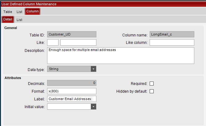

Are you using APR to send out the documents? If so the routing rule should show which email address is being selected for that document type. We use a UD field on the customer table that can store multiple email addresses, and use the data in that field to email our documents, because the email address fields on the contacts are too short to store multiple email addresses (and customers want things sent to multiple people).

@aosemwengie1 Are those UD fields just tied to the customer master or within the customer contacts? Any screenshots you can provide would be appreciated!
We added a UD field to the primary customer table, but you could easily add it to the contact instead. We just didn’t need it to be that complicated.
Then we did a UI customization to display this field instead of the standard one.

Are you asking about the kinetic version of the UD column maintenance screen? It should be the same?
@aosemwengie1 How did you make your UD field available in the both the condition and the email template of APR?
Just added it to the report data definition
