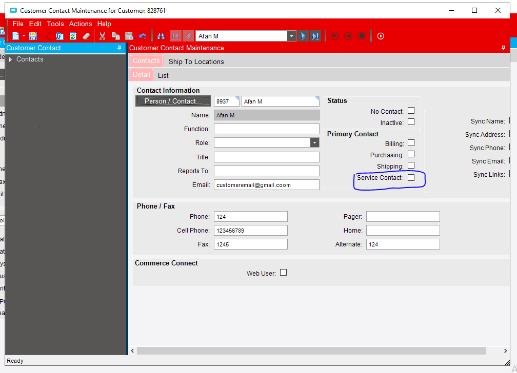

I was wondering if someone could assist me. I have recently placed a customization on the customer contact entry and when I access the form out of customization mode I am unable to locate it. Is there a possible reason this could happen? The first image is when the customization mode is on and the service contact checkbox I have placed is visible. The second image is when customization mode is off and the service contact is not visible.

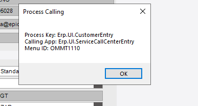

I believe that the customization is not set on the Menu ID and therefore it is not showing. So I tried locating the Menu ID however when I look up the Menu ID. The menu ID shown when the process is called is OMMT1110. See screenshot below, however that menu ID is the customer entry form.

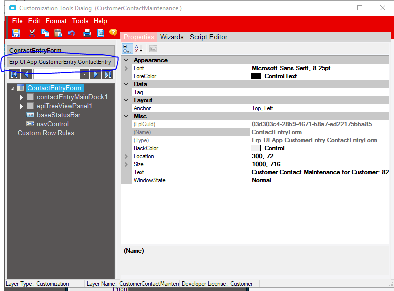

The last thing I have tried to do is go into customization mode in the contract entry form and take the ERP.UI.CustomerEntry.ContactEntry and taken that and created a new menu ID for it and this has not worked either. See screenshot below

I am unable to locate the menu item to make sure that the customisation is on the menu ID. Do you perhaps know the menu ID of this form?
It should be Person / Contact
The menu is available in Multiple locations.
That form does not carry the customisation, I have just checked it

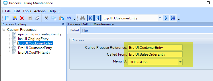

For others, see Process Calling Maintenance:
