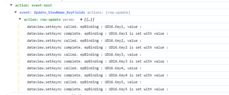

I am seeing that all the Key values are set to blank:
I do not understand why this is happening as I have the textbox properties set with epBinding ‘UD16.Key1’ and ‘UD16.Key2’ to handle the key fields and create the unique record. I just do not know what I am doing wrong. Are you aware of any literature/videos that walk through this type of scenario?
It looks like your row-update is setting them to blank. If you’re typing them in to fields that are already bound, THAT is adding the value to the dataview/dataset.
If you then run a row-update with empty values, it is going to over-write what you typed in the fields with… well… blank values.
If you’re typing the values into the fields… don’t do a row-update. instead, do a rest-erp to Ice.BO.UD16Svc / Update. This is what pushes the typed values from the local dataset to the server datatable.
