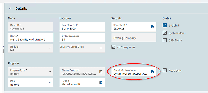

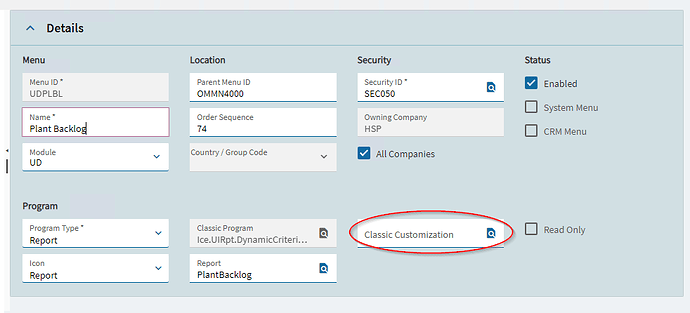

They are missing from the menu in the browser. I have looked at the built-in report menu items that DO appear in the browser, and they all have the classic customization field filled in. My report menu items aren’t customized so there aren’t any customizations selected on the menu.
It doesn’t appear in kinetic menu maintenance (why???) but the Web Resource URL field is also blank on my custom report menu items in ice.Menu but populated for the system report menu items. Even if I manually update the webresourceurl based on what I think the setting should be, it doesn’t solve the problem.

Example of a built-in menu item that works in the browser:
My custom report that is missing in the browser:

Out of curiosity, if you clone the system one and remove the customization that’s on it, does it behave the same as yours?
Interestingly, it didn’t work when I created it, but when I filled in the web resource url with ‘metafx/#/view/Erp.UIDynRpt.MenuSecAudit’ in ice.Menu then it worked even with no customization on it.
So really the missing web resource url is the problem. The problem is ‘metafx/#/view/Erp.UIDynRpt.[myreport]’ doesn’t seem to exist.

I still can’t make it work with my original Report type menu item to launch the kinetic report selection screen, because it doesn’t show up to select in the Classic customization selection box, which is how the system report type menu items are set up. Only BaseExtension apps show up in the list to search.
