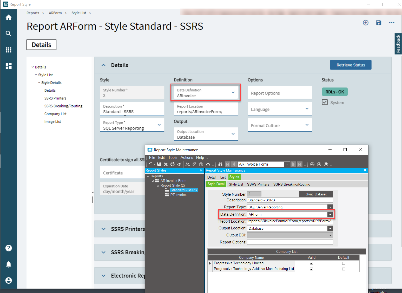

I found a couple of reports on the finance side that broke for us, 1 example being AR invoice form, were there’s it’s actually an entirely new RDD, in E10 it’s ARForm were as in Kinetic is ARInvoice or something along those lines :slight_smile:

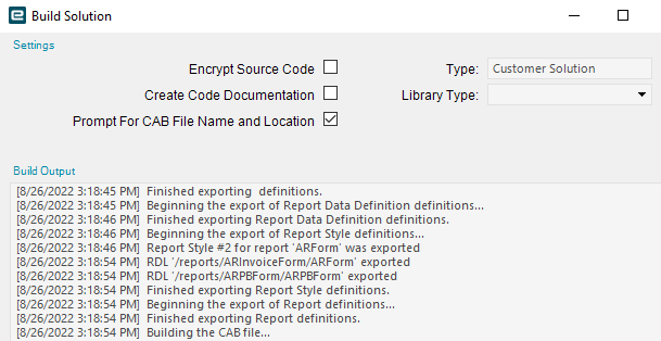

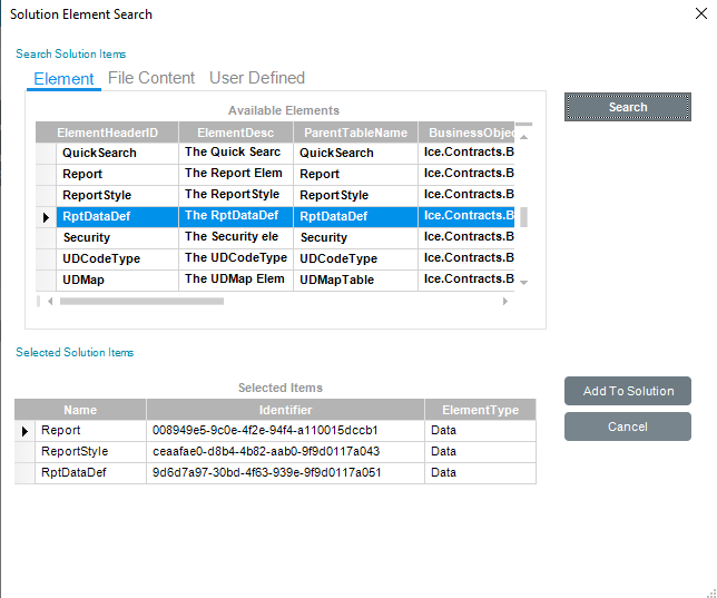

We
  • fixed the report in our Kinetic Test/Pilot first
  • used Solution Workbench in Kinetic to create the Solution (RDD, Report Style, and Report)
  • Export the .Cab from Kinetic
which downloads your “fixed” versions from your Kinetic Instance. Note all three elements are in the .cab:
On upgrade events (test or launch), make a note to install these .cab files into your freshly upgraded instance. We do the same for fixed BPMs and Customizations for classic screens moving into Kinetic.

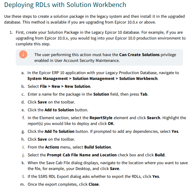

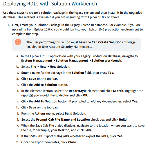

@gpayne It’s interesting, Epicor’s own upgrade guide instructs users to use the solution workbench FROM E10 and push to Kinetic:

Ahh fairs, I had the same issue with RMAForm, I ended up taking a copy of the report style in Kinetic and styled the SSRS thereafter. The majority of my custom SSRS stuff uplifted no problems but I did find one thing to keep an eye out for is if there are any changes where the base styles RDD is different between versions.
AR Form is a prime example:
