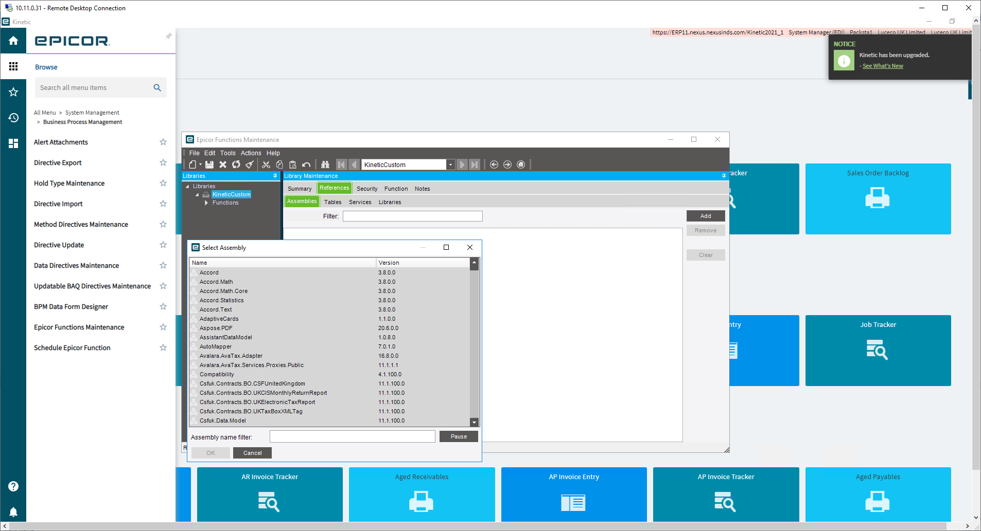

Can any body tell me if I can import a custom .net library which I have written into a Epicor functions library as shown below please?

On-premise you would need to put the DLL(s) inside the Server\Assemblies folder to be picked up.
Not sure we would actively support this but can be done technically!
Hi
Thanks for that, I can find the Server folder but not the Assemblies, do I need to create it?

it’s the server folder in wwwroot not the Epicor folder tree.

I always put mine into Externals and it picks it up. So when I do upgrades it remains. Or I add a second Assemblies Path in the web.config
If you want to add like a 3rd party dll you should make another folder and you can add it via admin console there is a section right above Shared Assemblies (cant grab a sshot now)
