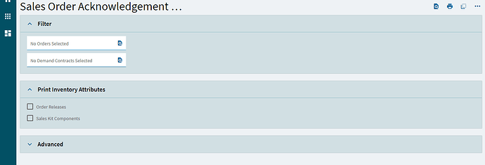

I just want to create a menu (like Job Pick List, for example) where it simply opens a print screen, the user can search or type in the order number and print the Order Acknowledgement.

There is already a menu for that . . . Mass Print Order Ack

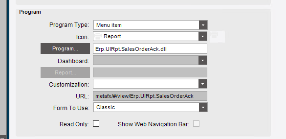

I thought it was but maybe it isn’t! So many customizations here from before my time. Here is how they set it up in case it helps you . . .
Sweet. Its a place to start. I’ll create that menu on my end and see where it takes me. Thanks for the quick response!
Wow… that was easy. Just create the menu tied to to the UIRpt and done!
