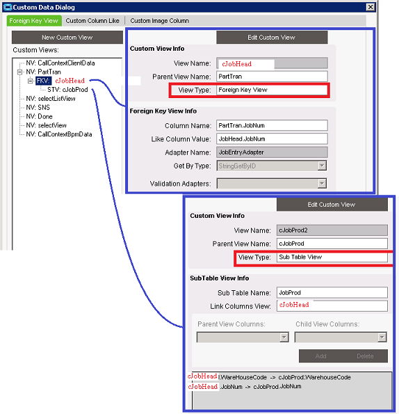

Looks like you want a messgebox to pop up and show any previously received - JobProd.ReceivedQty?
I wonder if you have tried the lookup in a BeforeFieldChange instead of the EpiDataView notification?
Just a guess, off the top of my head… based on a similar lookup I previously added to the End Activity form in MES.
Alternatively… in another, similar customization, I added have used FKV(s)
instead of custom code to lookup related values.
i.e. sometimes I add “reference only” display fields instead of a using a messagebox.
Ref screen shots of a quick example of customization I added to the Job Receipt to Inventory form.
