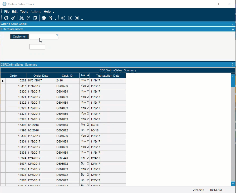

I have a customer search button that’s opening the Customer Search view but whenever you select a customer in the search it doesn’t actually update the text field with the selected CustID… I can right click on the CustID text field and select Open With → Customer Search and whatever you select in there will update to the field, but my custom button is not.
I can have it write to a CallContextBPMData field and as long as a text field is binded correctly then it will update - but the CallContextBPMData fields have no filtering properties on the query so that’s useless… How can I alter my code to update the binded CustID field with the selected Customer in the Customer Search?
Note - I am using the Simple Search Customization Wizard to add the code.
Here’s the code -

The GIF below shows that it’s doing… Whenever you select a customer from the search it’s trying to update the actual query result field “CustID” and not the “txtCustID” field in the tracker view.

That’s all working properly but here’s my problem - the query is running like there’s no tracker view whatsoever. I select the customer using the button and it goes into the field, but the field isn’t attached to the query so it’s basically an empty field according to the query… How can I make the query filter on the customized text field?
Also the since the field is binded to CustID it’s saying it’s read only and I can’t change it at all
