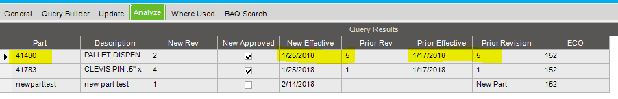

I am writing a query to return the current revision and the prior revision in two different columns. When I write it in the BAQ designer it takes 15 seconds to return 3 parts. When I paste the code in SQL Management Studio it runs instantly. Any thoughts on what I may be doing wrong or how to improve the BAQ performance?
BAQ Output:
Top query:
The sub query is basically generating a rownumber and sorting by effective date descending and the top query is filtering the subquery by row two for the prior revision.
