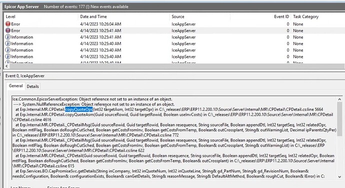

We recently upgraded to Kinetic 2022.2, since then we’ve had a bug with CTP for jobs coming from Quotes. If we create a line on the order manually, not from a quote, the error doesn’t seem to appear.
Here’s the error pop-up we receive when running CTP.
Here’s from event viewer.
We have tried disabling all BPMs associated with Quotes, Jobs and Orders and used the base form. Still get the same error.
We have created a case with Epicor but was hoping maybe someone has ran into this problem before and could offer some help. Thanks in advance!
