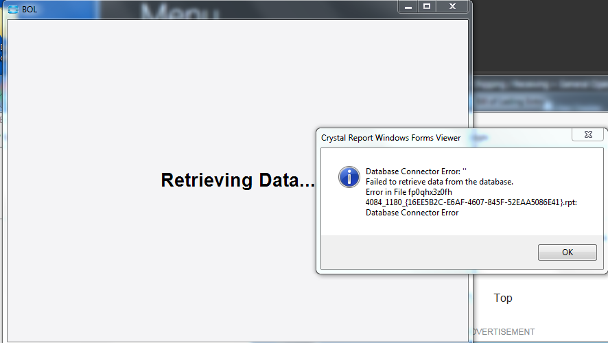

We created a BOL form using the standard Epicor V10 Crystal Report form.
We added a subreport that looks up some information (ShipHead) using the ODBC MS SQL Driver V11.
I can run the report just fine from the Crystal Reports Developer/Designer. However, when I try to run it from our V10.1.500.11 server - I get prompted for my ODBC username and password - but then I get two erorrs that look like they are related to the Crystal XML.
Has anyone seen this before? Any suggestions?

Similar happened to my OpenEdge E9, it was client failed to access \EpicorData for the xml.
You will need to open the report in Crystal Reports. Click on Database from the menu bar, then Set Datasource Location. Find the report you just ran and Update it. Do this for subreport as well.
