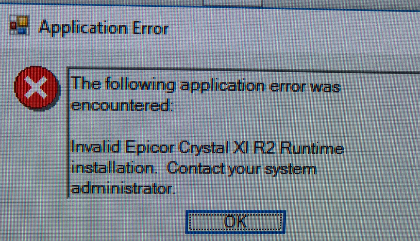

Downloaded from epicweb the Crystal XI R2 .Net 3.0 Runtime SP5 file and installed it on a windows 10 machine. However if we try to print preview a report we get the error in the below screen shot. I have confirmed that no other versions of the runtime are installed on the client. Any help is appreciated.

Yes that error is what I get when I try to print preview a report. I don’t see the SP6 version in epicweb?

Well I just figured this out, rebooting the client that I had installed the runtime on enabled it to work! We can now print and print preview reports. Thanks for the help and responses.
