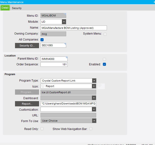

  2. The main thing I have tried that I thought might work, is creating a new menu, and adding the old report to it witih throws an exception when I try to run it
    Below is what I currently tried

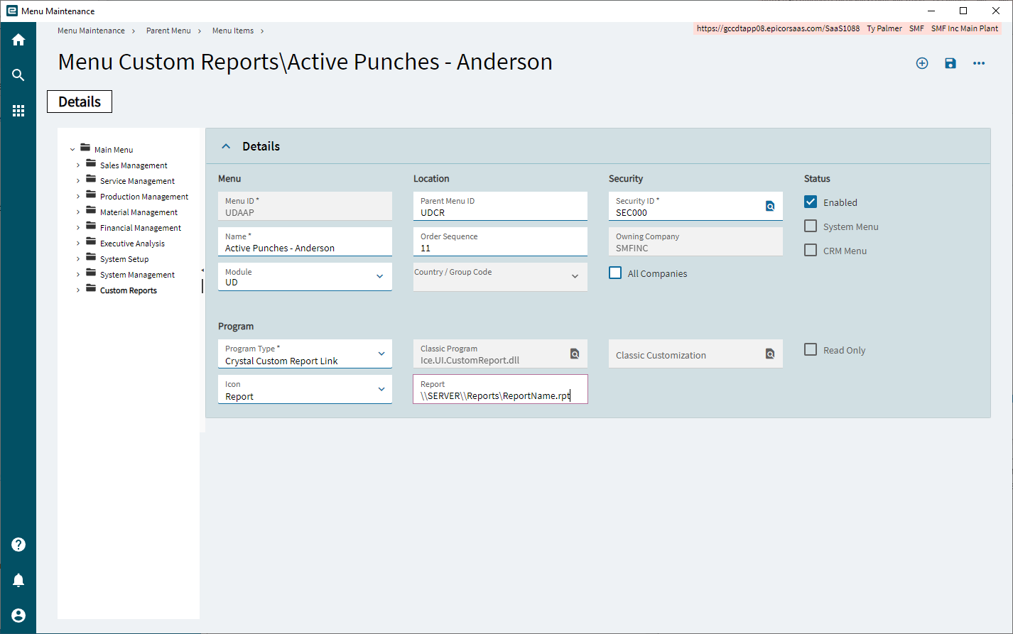

We upgraded to Kinetic Cloud in November '22. We have multiple custom crystal reports that work. We had to get a READ ONLY environment, which is a copy of the LIVE database, so that we can read the data using a DSN file. Epicor sent all the connection string info and all we had to do was build the connection in Crystal Reports. It works great. But please note, this only works in the SMART client and not the URL client. And only if your users can access the location where you store the report, i.e. a server share. So remote users without a VPN are out of luck.
And of course, you still have to install the Crystal Reports runtime on each workstation.

Here is what the menu setup would look like:
